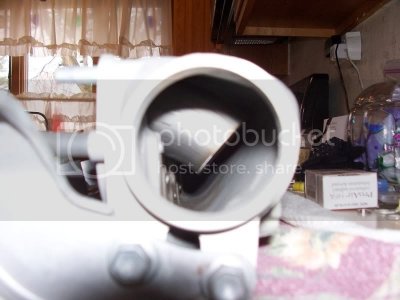

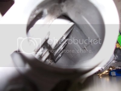

I made up a set of BBB airhorns to help smooth the transition into the port ( get rid of the nasty step when you get rid of the factory air horns) and get into some clean air away from all the casting crap on the plenum wall. I made them on a lathe so i matched the outer diameter to fit the plenum hole and the inner diameter to match the BBB size. The airhorn walls are pretty think and i was able to flair the tube a little and make a smooth radious. I guess it would close to number 3 in the above chart. I made a couple different shapes and length but it boiled down to installation, once you build them you have to install them, I had to install these by inserting them in the cross over tube hole.
000 0015
P.S They were installed with no welding, just some set screw drilled and tapped from the outside.
000 0016
I also tried a set of curved ones ( mandrel bent aluminum) but could not get them installed after they were flaired ( sort of cutting up and re welding the plenums) and running tubes with out a bell mouth is a waste. If you realy need to mod your intake farther then this I would suggest just starting from scratch.
100 0909
To be honest this is all guess work , with out a flow bench and dyno numbers Im just duplicating what seems to work in other proven intake systems.

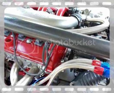

In addition to the Weber example you show, I recall that Hilborn makes direct port fuel injection systems (used often on sprint cars, IIRC) that use tuned velocity stacks. You never see these systems without these stacks, and they come in various lengths.
It's kind of hard to ignore that photo of the Beemer V8 system...
Pic of sprint car engine: http://www.world-sprintcar-guide.com/sprint-car-engines.html
Pics of Hilborn injector systems. Don't see very many without velocity stacks: http://www.hilborninjection.com/category.asp?Id=187
So, I'm not big on just removing velocity stacks without some research, even with BBBs.
