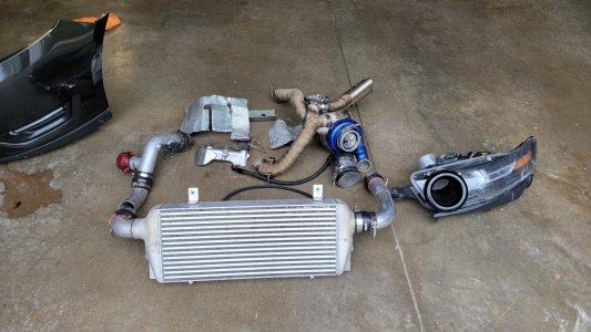

Figured I'd update you all on the car. A month or so ago I decided to tear everything out for a 7.3L godzilla. The rwd set up is going to be key in that!
That being said if someone is in the market for a very built engine or a single turbo set up for big hp slide into my dms. The built transmission has already made its way to someone else's ownership. Lots of the little bits are already gone. If install is an issue and you're able to get to Missouri I can also do installation in my shop for ya.
Engine built to handle 1000hp+ Runs 30lbs of boost no issue
7,000 ish miles
LMS Coated crank
Upgraded rods and pistons
Closed deck
ARP Head studs
Ported and built heads
Single Turbo kit (downpipe also for non hood stack set up)
V band converted exhaust manifolds and exhaust routing to turbo
Garrett GTX3576R gen 2 w/ tial backhousing (750hp rated)
Tial Wg 44mm
Tial BOV
Precision intercooler
Oil lines
Charge pipes
Electronic wg controller
