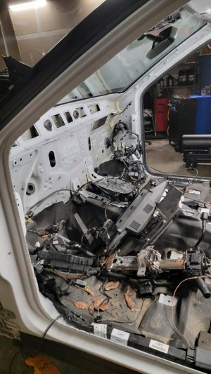

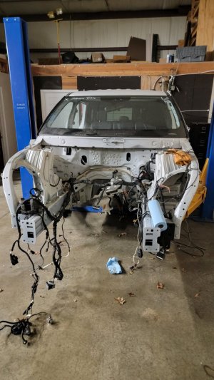

Working on feeding harnesses through. Slightly lost my mind today. Had to plug some stuff back in so I knew which plugs are the essential ones lol. Not bad progress for a couple 4 hour sessions so far.
1000028057
Removing all the harnesses from the car to plug everything in on a pallet and make it a running engine before the fabrication for the taurus starts so I know I've got the proper set up.
1000028058
Unfortunately the dash has to come out to feed back the harness through the dash. Well I'm not sure it has to but I'm willing to bet this is the easiest route. Kind of neat to see the stripped accessories in these police vehicles. Plugs that just have dummy fittings in them to keep them sealed and what not.

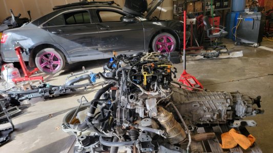

Sometimes you're on the engine looking at the car and sometimes you're in the car looking at the engine. Don't mind the purple wheels. I figure I'm going to have about twenty hours of looking before a real plan is thought out. This won't be a solo project by any means.

Plan is to use the entire subframe out of the explorer. Solves so many things with replacement parts, alignment and what not. Cut some stuff out the way and build around the existing subframe. Take time, do it right and think about servicability!
