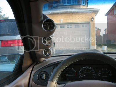

DDakRT, those are the gauges that I have. But I made a panel for them where the EATC normally sits. How is the brightness of the A-Pillar? Mine are a little dim at night where they sit right now.
