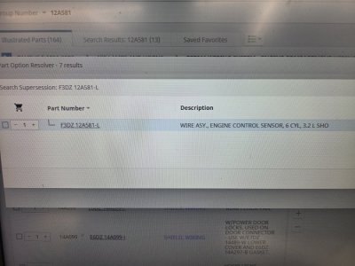

Looking for help on 93-95 SHO 3.2 engine wire harness. Ford dealer is telling me the part number for a 3.2 / automatic is F3DZ-12A581-L. That number comes up NO WHERE but F3DZ-12A581-G does. Wonder if anyone on here can confirm what the right part number might be.

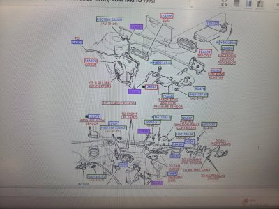

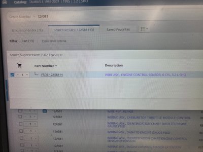

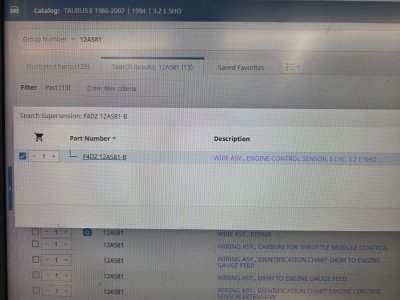

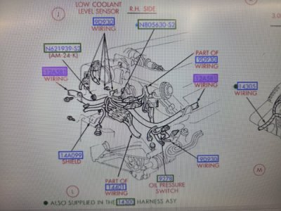

If you are referring to the harness that runs along the back side of the engine to the PCM (highlighted purple) then that is the correct number for a 93 ATX 3.2. It changes to F4DZ-B in 94 and F5DZ-H in 95. These are coming directly from the Ford parts catalog.
