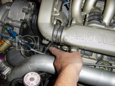

you want to tap into the 02 wire on the ECU side, not the 02 sensor itself. In my ex 91 I tapped into the ECU 02 wire located in split loom coming up near the oil dipstick tube/ intake plenum. I BELIEVE it is a BLUE wire. I am not 100% sure though. (maybe green, ahh heck...)
It is JUST a light show though/ gauge pod filler :biggrin:
However, $300 is too steep for the real deal (wideband 02) IMO. Unless your sho is a dragster.
Here is pic.:
