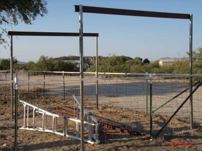

Switched gears for a while to put in a 10x12' shade area for my daughters horses. Unfortunately the daytime temps have really jumped - and working out in this heat for hours really tares me up. Gonna try shifting to early mornings before work, but if I can't swing that it'll have to wait till it cools down some. That would mean back to the 914 - darn!

Well, been working a few mornings for a couple hours before work to get the horse shade up. Got the four posts leveled and ready last week and cemented in yesterday. Then spent this morning getting the two side channels up, leveled and attached. That is after I spent half an hour corralling the horse back in after they got out.
So next are the cross purlins and the R panels.

I hope you're going to cross brace or shear at least two of those sides. With the wind gusts you need all the bracing you can get.
Tom
3d914
Feb 1, 2008
832
338
Tom
Good catch Tom. There are actually three cross-bracing purlins going in. Got two of them in this evening. The design doesn't call for side bracing, although I may end up adding it so that I can provide additional shade on east & west sides.
