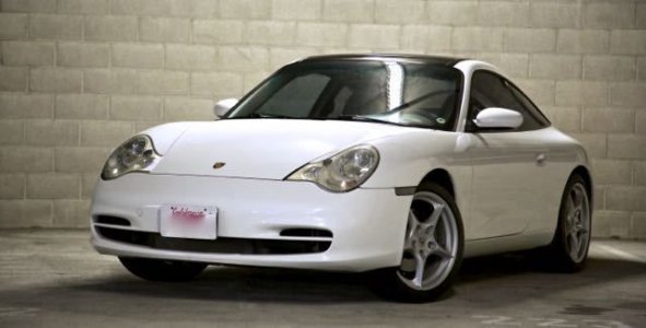

Got to take a break last weekend and make a run out to the G&R 914 Swap meet in Riverside. Was able to meet up with my son. Got to drive his Targa. Also picked up a couple of rear trunk lids.
