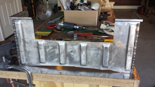

Took some time this weekend to try and close off the rear firewall to the trunk. Since I'm trying to reuse some of the original panels - its been slow piecing things together.
Also getting to use the new work-bench. This is the first metal-work/welding that I've done on a flat surface. Everything else has been welding in-place, on the car.
First I had to add a piece to close off the ribs.

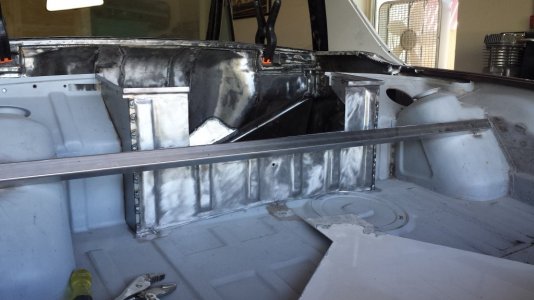

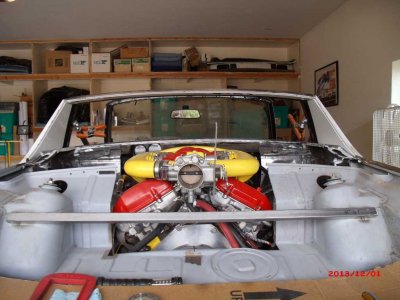

Another hot day, but I was able to get the firewall insert mostly roughed out. Still have a bunch of welding to do on the parts and to put it in. Here's the hole with the motor in so you can see what's getting closed up.

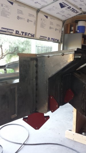

Here's the parts spot welded together.
Post 1191 1468204734

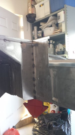

Left and right installed temporarily.
Post 1191 1468204802
Post 1191 1468204813

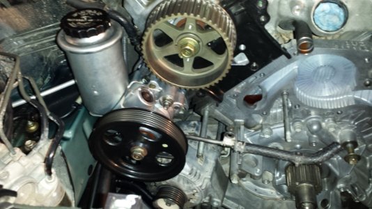

Haven't spent much time on the 914. Spent a couple weekends with my son home working on his bike & his 996. Mostly been working on concreting posts in between all the rain, and finishing up work on the LS400.
The LS400 turned into one of those - while I'm in there . . . jobs. Started with a failed starter, then a dripping water pump, stuck fan clutch, and a leaking power steering pump. Water pump is off and power steering pump has been resealed and haven't even gotten to the starter yet - which just happens to be buried at the back of the top of the motor underneath all the intake stuff.
Gotta love it.
