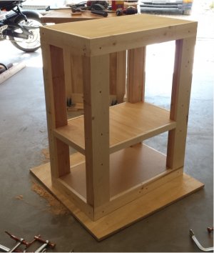

Finally took some time on this three-day weekend to work on the 914-SHO. Spent a couple of days finishing up a fish tank stand for my daughter.

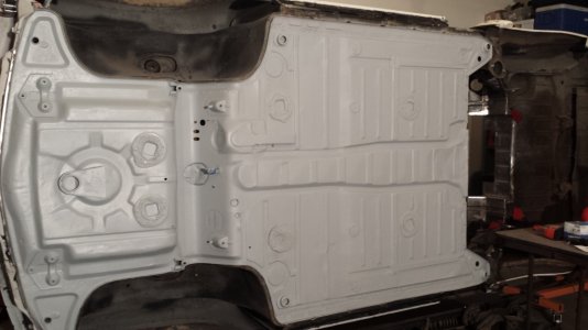

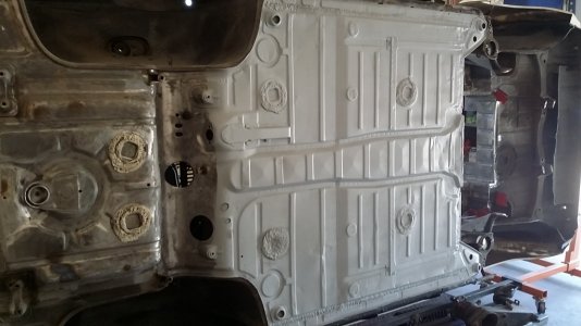

It was my plans to get the 914 into paint by now, but other priorities pushed it back. I did however get around to getting part of the underside in primer. Now I feel a little bit better. Hope to finish up the front this week. Got some metal cleanup to finish before primer.

Looks good even primered! Will the fish tank reside on top of the stand or the next shelf below? What kind of wood is that?

The tank stand is just made from pine. I used 1-by's for the outer framework with 2-by's for the inner supports. The upper shelves are 3/4" ply except for the 1/2" particle board for the bottom shelf. Both upper shelves get tanks. The middle is for a 10 gal and the upper for a 20 gal.
This turned out nicer than the 2-by ones I've built in the past, but none of those needed a middle shelf capable of supporting a tank. That's why I tried a different design - using inner 2-by's only for support & to carry the weight.

Got the front portion cleaned up and primered. Once I decide on the undercoating, I'll get a paint that contrasts in color so I can make sure I get the undercoating where it needs to go.

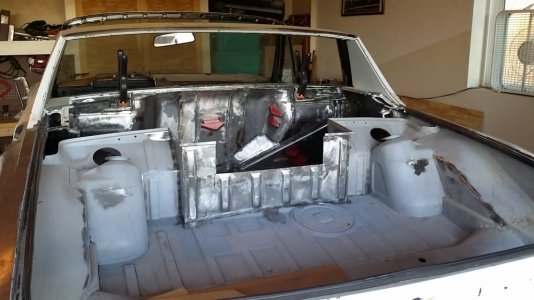

Rear Trunk
  • Complete firewall modifications
  • Seam seal trunk
  • Build filter box & support frame

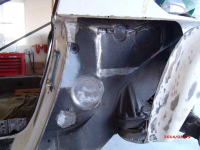

Finally got the rear firewall section welded in. It will get some finish work, primer, and seam-sealed - hopefully before the end of the month.
Post 1191 1476579017

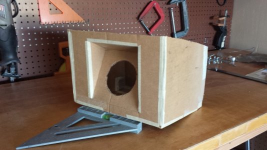

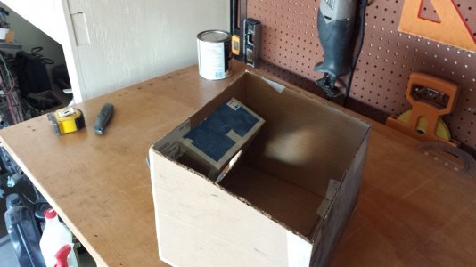

Got some time to mockup the air box based on my CAD data. I already have the plastic, so this just verifies dimensions and fit. I'll also use it to position pieces for cutting on the plastic sheets I bought.
Post 1191 1476677367

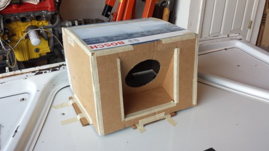

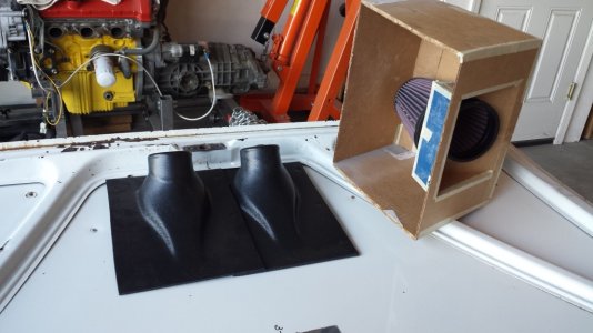

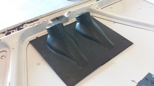

Spent the rest of the afternoon positioning the NACA ducts and filter box on the trunk lid. The ducts get quite a bit of trimming, but I wanted to make sure they would clear the filter as planned. I also need to fabricate the cradle that holds the filter box. I think I'm going to design it to act as the mounting point for the trunk lid hinges as well.
So here's the NACA ducts positioned. They'll be trimmed up and formed slightly curved so they fit the curvature of the trunk lid. At final assy they get cemented in.
Post 1191 1477098317
The filter is centered and angles toward the bottom of the box, and the ducts are to each side so there is no interference. Since the ends of the ducts get cut off - they just dump air into the box.
Post 1191 1477098332
Here's the box as it sits on top the ducts. There will be rubber seals that seal the air box to the underside of the trunk lid. Part of the seal will likely end up mating to the back side of the ducts.
Post 1191 1477098342

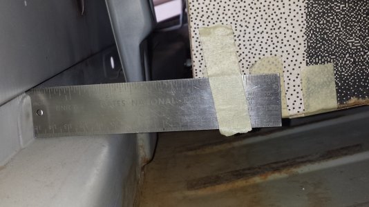

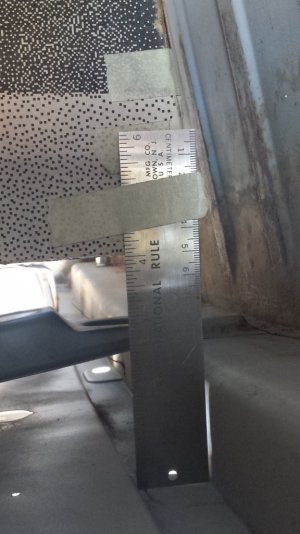

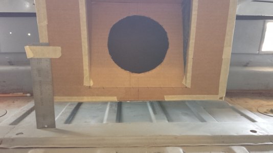

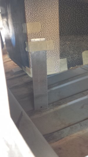

Finally, I've placed spacers under the air box mockup to represent the ducts and the seals. Tomorrow we'll put the trunk lid on and measure the remaining space to the floor of the trunk. From this I can fab the framework to hold the air box.
Post 1191 1477098353

Are you going to insulate the filter box?
SHOdded, I wasn't planning on it. The stock motor draws air from the engine bay which draws air from above. Mine will be similar except it will draw air from the trunk - via fresh ambient air. With the trunk firewall closed off - for the most part, it should reduce the movement of hot engine air into the trunk, though all the exhaust under the trunk will be enough to warm it up above ambient temps.

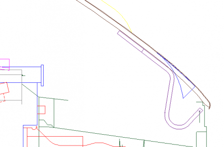

Spent some time this weekend checking the design for the trunk lid opening in the opposite direction - hinged at the back. Now that I have the mini hinges I can verify dimensions and fit. I'll need to extend the end of the hinge by six inches and decrease the bend angle for the arm by a little more than 11 degrees.
Here's what it looks like in CAD with the modified Mini hinge. The thick portion under the sheet metal is the support webbing. I'll be adding additional webbing from spare trunks so the hinge can mount to that.

I had some challenges figuring out the modifications needed for the Mini hinges. Found a used set on ebay and was able to get dimensions off them. I can even retain the mounting bracket. Once I got the dimensions in CAD I was able to verify the movement of the trunk and the hinge to ensure no interference. The air box has been mocked up in cardboard and test fit. I now have the dimensions to begin the framework design that support the air box. I've decided to combine the hinge framework with the air box framework, and already started the design work. I have a metal supplier in Tucson who will cut the framework pieces for me from the CAD data - which will be faster than me attempting it by hand.

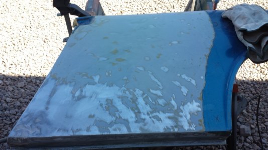

Working on closing up the left quarter panel - right behind the driver's door. Started cleaning the used panel I bought and removing paint - only to find some damage in the lower-left corner. Aside from the damage in the corner the panel's in good shape.
Post 1191 1478305821

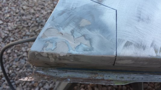

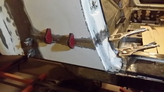

So this section will have to get cut out and I'll make a patch to go in its place. Then it will get cut with the rest of the panel to fit between the door and the flare.
Post 1191 1478305848
Post 1191 1478306268
