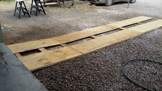

Before I could do any blasting I had to build a ramp that I could roll the rotisserie out on. Gravel just doesn't cut it. Had lots of scrap left from the car lift crate so it's not going to waste.

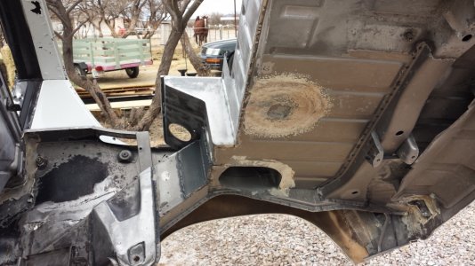

The blasting progressed a little slow until I got things dialed in properly. Had Friday afternoon to work on that. Love the look of the clean metal. Using a tarp under the car and plastic sheets surrounding the work area I was able to reuse almost 75% of the material.
Post 1191 1487045020
Then was able to spend most of Saturday working on the engine bay and under the trunk. Cleanup after soda blasting is a big job, but it's well worth the time saved. Sunday started to get humid and rained in the afternoon, so didn't get much done then.

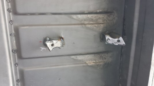

Decided to remove the muffler heat shield. I wanted to drill the welds from inside the trunk but was unable to locate them accurately. Decided to do them from the shield side. I've got nuts I'll weld to little stop plates that will go behind the drilled mounting brackets. They get flood welded then a single hole drilled for a hex bolt.

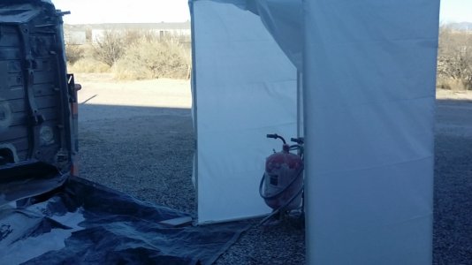

Had another 3-day weekend so spent Friday & Saturday blasting. This is tedious work - especially in the engine bay. Put my sanding booth together hoping that would make it easier to move around and still collect the media so I could reuse it. Worked OK, but not great.
Post 1191 1488149409
I kept the opposite side covered in plastic also to help contain the media. That and the booth weren't air tight but I was still able to collect about 50% of the media. I've only been able to get one reuse out of it because it starts to break down into finer particles and just blows away when collecting it.
Post 1191 1488149397
The other factor is keeping dust off the hoods plastic lens. It collects soda dust after 5-10 min and makes it hard to see. I keep missing little patches that will have to be cleaned up later. Gettin a little frustrated, but still making progress. Probably have a couple more days just to finish off the engine bay and rear section of the trunk - then I can primer.
Post 1191 1488149422

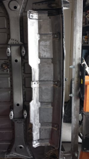

Spent some time finishing up the heat shield. Decided to add some reinforcement to the back-side of the supports - so I could use bolt & nut. Also added reinforcement to the underside of the heat shield where the welds were.
Support reinforcement
Post 1191 1488587399
Heat shield pad reinforcement
Post 1191 1488587416
Heat shield bolted in. Since it was cool out I was able to get it primered.
Post 1191 1488587435

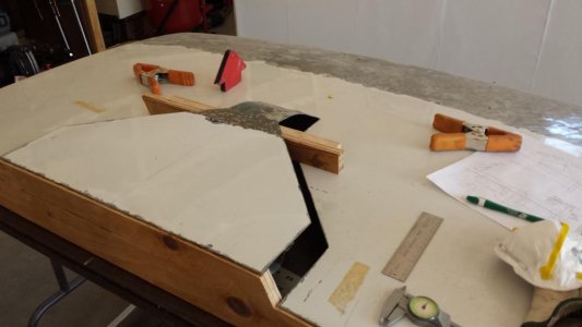

Also was able to get a form built to guide the metal work on the raised portion of the trunk lid. Of course I also found that I don't have any steel of the right gauge so I'll have to run over to Tucson for that.

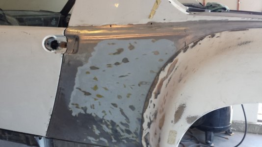

Good progress this weekend. Now that I have the materials to finish all weld seams, repaired surfaces, and reblend the rear flares. Found a local shop that is assisting with prep materials. Using Durglass for reblending the rear flares. Got a good quart of All-Metal to finish weld seams before applying seam-sealer (which I also picked up).
Found a good body cement to reglue the portion of the flare to the new panel. Had to order a couple special clamps though to hold things, so looking do get that done next weekend.
Also have some good finishing bondo to smooth surfaces. So bulk of work now is to get ready for primer. I still have a lot of body paint to remove (via media blasting) but focus for now is finish all repair work areas first.
Picked up a small piece of 18ga steel to finish off the rear trunk mods. (See previous post).
So spent the bulk of my time finishing grinding & sanding repairs. All under body & engine bay soda blasting was also completed this weekend.
Left panel:
Post 1191 1494810686
Right panel & door jam:
Post 1191 1494810695

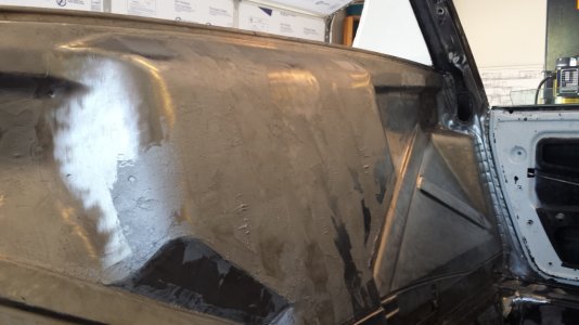

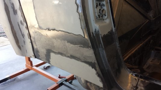

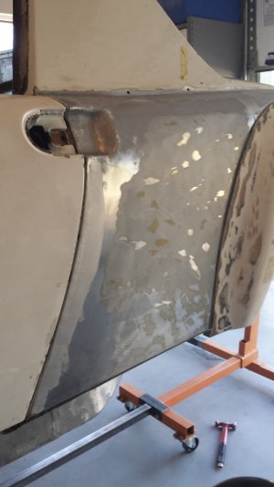

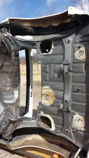

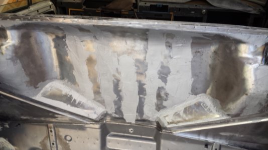

Spent today doing the rest of the prep work over welds. I'm using All-Metal as a surface filler over the weld seams to fill pinholes and blend. This seems better suited than Duraglass or Bondo since neither of them is watertight where All-Metal is.
It's a challenge to work with only in that you have to use only enough that you can cover in a couple of minutes. It sets up real quick. So it ends up taking time to mix up all these small batches. But the results will be worth it.
First areas were the front & back side of the main firewall.
Post 1191 1495322491
Post 1191 1495322499
The left panel
Post 1191 1495322546
And the right panel/door jam
Post 1191 1495322585
I also went ahead and covered the rear portion of the trunk. This had some surface rust that's been treated, but rather than leave the rough texture, I decided I'd cover it with the All-Metal and sand it smooth. This should provide some additional protection as well.
Post 1191 1495322693

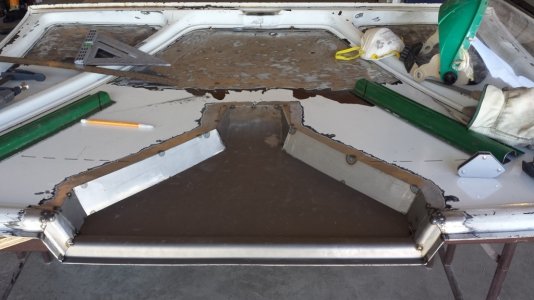

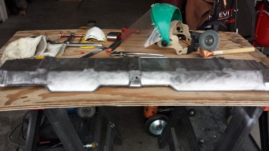

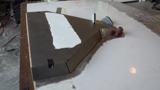

Spent more than six hours on the trunk lid riser section. Because of the curve along the length of the trunk each piece had to be curved accordingly and fit. My back is sore from all the bending over the substitute bench (folding table), but at least the pieces are all cut and mostly fit. I'll spend some time Monday doing some more spot welding to locate everything from above, then I have to add the bracing underneath along the front.
Post 1191 1495936893
Post 1191 1495936903

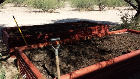

Been an exhausting day. Been moving a lot of earth around - even though a neighbor helped with his tractor. Trying to finish up the planters I promised the wife.

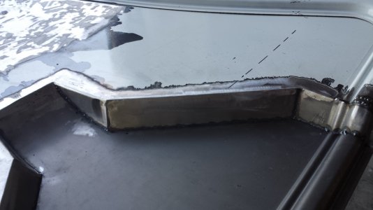

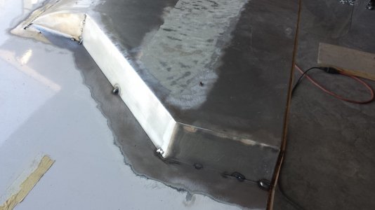

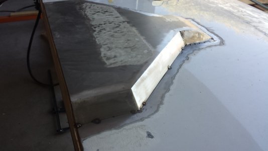

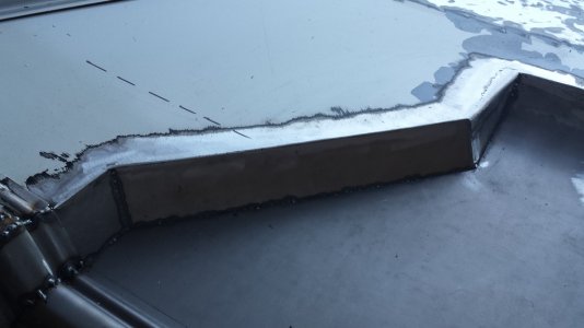

Made some good progress on the riser portion of the trunk lid. Managed to get most the outer and inner stitch welding done and grinding finished. I was actually surprised by the results. Working with this thin metal has turned out to be much easier when doing it on the bench - as opposed to doing it on the car. At least on the bench I can clamp things in place so they can be fitted and welded better with less movement.
Outer trunk lid
Post 1191 1497711914
Post 1191 1497711925
Inner trunk lid
Post 1191 1497711935
Post 1191 1497711944
