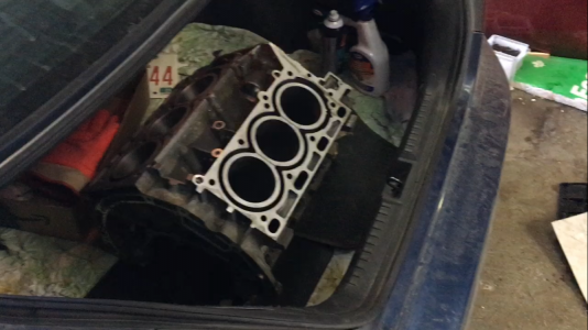

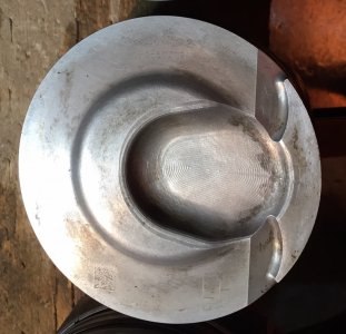

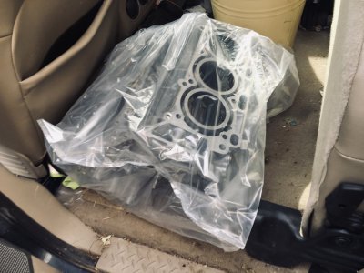

I did some work over the holidays, not too much, I ate a lot, I didn't waste any time with the car LoL

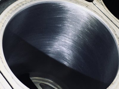

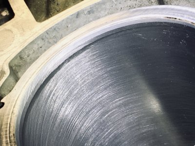

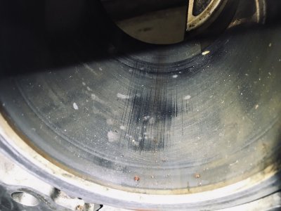

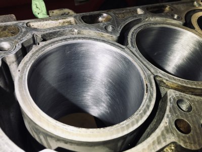

Finally some time to make some progress. Today is to deglaze cylinders and get that crosshatch. What I'm not sure about is:
1/ if I can leave those black rings on top of the cylinder. Everything is getting nice and touched by the stones but this. The compression ring shouldn't be that high up I believe so it shouldn't be a problem. I don't wanna take too much material off...
2/ I hope it is visible but I also still have a tiny vertical scratches in there. Very tiny. It was way worse before. I can't feel them with the finger nail though.
Thoughts? Should I run the stones until everything is looking the same? My goal here is to put together a fairly good running engine on a budget.

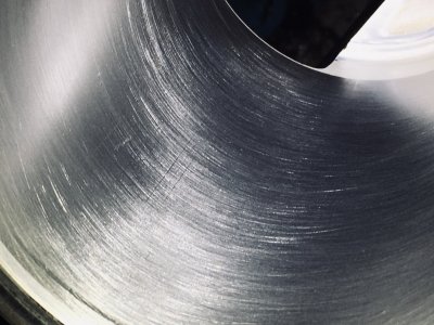

That was my first try. I did it one more time and almost all imperfections on the surface are gone and with a nice cross hatch I believe but I took too much material off of the top, that's why the taper. I'm looking for Lisle 15000 to even that out.

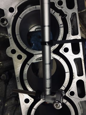

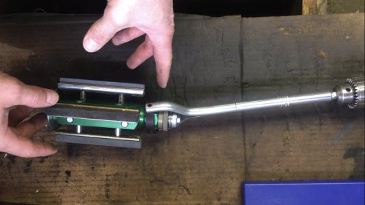

I made a mistake by using that 3 stone hone for my engine. It's really good just for deglazing if the cylinder wall is within spec. My wasn't. It has taper and it has out of round. What was I thinking?... Now it has more taper. Not happy but learned a lesson the hard way.
So I bought this Lisle 15000 with 80 and 180 stones. I should've used this rigid hone from the beginning. I had to make those stones straight to each other, there was almost 1 mm difference in distance between the top and the bottom. They provide a little wooden stick with a rough grid sand paper on it. I installed 180.

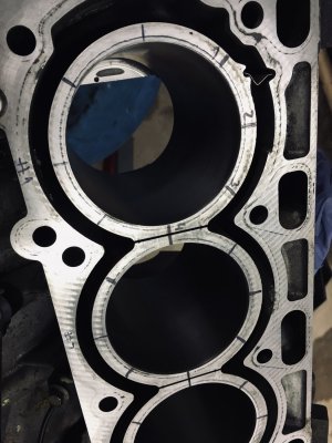

After that I measured all cylinders in 6 spots from the top to the bottom. See picture. 1st at 5mm from the top of the block, then every 25 mm. The 2nd mark I made between 5 and 25 mm mark because that's where the taper is the worst. So I wanted to see it hiw bad it is in that top area of the cylinder wall. I measured where is the piston groove for the 1st ring and it's about 8mm, so that's why I chose 5mm as a first mark. That measurement gave me not just values from axis X and Y but also from 2 more which gave me a better picture about the shape of the cylinder. You don't wanna see those numbers...they're bad. I'd probably need an oversize pistons. I'll post some numbers later.
Just a FYI - I made some marks on my dial gauge indicator (every 25 mm) and I used a zip tie. I wanted to make those multiple measurements easier and faster and accurate as possible at the same time. Simply put measure it always at the same spot. When I inserted the dial gauge inside the cylinder I lined it up with nr 1 mark, and that zip tie worked as a stopper. Then the same for nr 2 to 4, went to next cylinder. Then I moved the zip tie to the next mark, and measured again.
That Lisle 15000 compare to that 3 stone hone is like a day and night. No surprise. It's rigid. It evened out the out of round after few minutes of work. I started with cylinder nr.1 but didn't finish it, it was too late already. Now I'll measure all pistons, re-measure cylinders, m put all those numbers together and will see. But I'm pretty sure I'll need a new set of oversize pistons and rebore the block to that size.

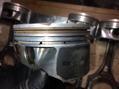

Like I said I bought a rigid Lisle 15000 with a 80 and 180 grid stones. I'm working on resizing the cylinder walls for 0.25mm oversize pistons with the 80 grid stones, due to taper, out of round and caving. I hone it dry and it's very dusty. You can hone it wet as well.
I made few mistakes, I learned everytime something new though, I fixed it. Still some room for error though. And my plan B still in place if I mess it up. But it's fun to do it home myself instead of sending the block to the shop, which is my plan B actually.
It's a lot of patience and measurements, insert the hone in to the cylinder, do couple of strokes, remove the hone, measure it, lot of adjustings of the stones, they have to be perfectly parallel, it is a pain until you get them work like they suppose to. I'm glad it's a 6 cylinder so when I mess something up on nr.1 I go to nr.2 and try something else some other adjustment and so on and on again until I figure it out and I get back to nr1 and fix it.

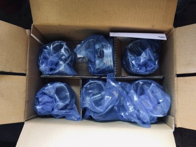

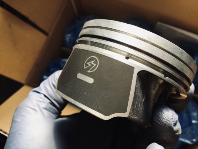

My new pistons finally arrived. Ready for some measurements and final cylinder wall honing with 80 until I get really close and then switch to 180.
