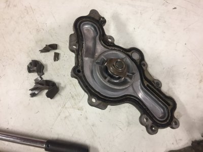

I took the water pump off and at first I wasn't able to move it by hand. I tried the opposite way and nothing. So I forced it back and forth and she starts moving but I felt the bearing is dead and it has a play. I found almost all broken pieces from the propeller sitting right behind the water pump. Almost all that plastic was RIGHT THERE waiting for me to discover it. Hm. Weird. I also double checked the oil pump sump pipe and the screen and I found very little metal shavings, 2 in size of probably like 4 and 6 mm long and tiny like a nail then just a very little metal dust. Next step would be taking the pistons out. Can't wait. I'm thinking about replacing the oil pump for a high volume model. Thoughts?

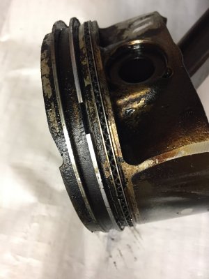

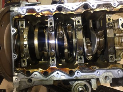

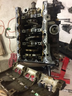

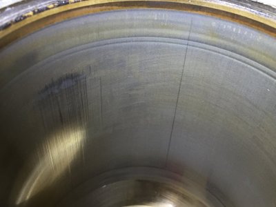

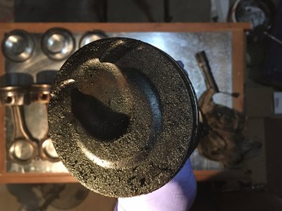

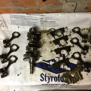

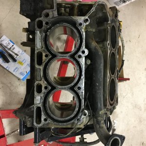

Cylinders look the same. All 6 like the one on a picture. I don't feel any scoring with my nail. I hope deglazing and new cross hatch will do the trick.

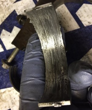

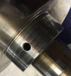

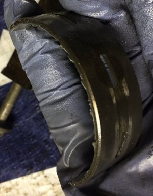

Crankshaft - main bearing nr.1 is shot. Totally. It looks like a cow chew it hard. That's the source of metal shavings I found on the oil pump screen.
Crankshaft main journal nr 1 looks like it has some scoring but again, I don't feel anything with my nail. The rest - nr 2 and 4 look good and nr 3 is shot a lil bit.
I'll do some measurements with thr tools I bought but geeeez, my boss she said it's a Christmas gift and I knew it beforehand... So I will have to wait 2 more weeks . There's still some work on cylinder heads, that would take quite some time.

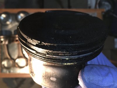

Pistons are dirty but all compression rings move easy.
Piston rods bearings look very good.

I'll measure the crank and will see. That bearing looks nasty but it's an easy replacement. And it won't cost a fortune.

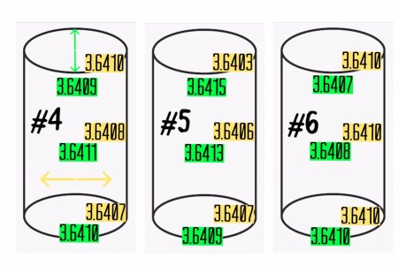

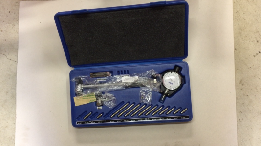

I measured all cylinders today. I believe I got that micrometer zeroed correctly, and the cylinder gauge set up as well. I measured it like 10mm under the top of the block, in the middle and like 10mm again above the bottom dead center. I had around -7 deg Celsius in the garage, so I'm thinking everything shrinks a bit in the cold, right, so did the block or I had shaky hands doing it...
The value should be 3.641-3.642 of an inch.

I just played with some tools and yes, the hard parts are in spec. I'm waiting for the offer from a local dealership, there are some good prices on rockauto out there and what I found recently is a fordpartsgiant.
Now I have to wait until the temperature outside goes at least above -15 C so I'm able to touch something LoL. Everything so cold, it actually can burn your skin... Deglazing is the next step, measuring again and ordering parts. That's a moment I can't wait for!
