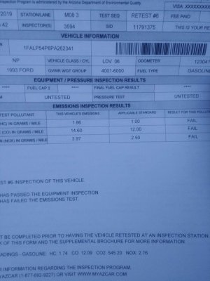

1993 3.2l SHO badly failed emissions.

Well, after fixing the air leak, my emissions went back up...

pulling the spout connector usually drops them around 50% so your experience there is in line with what others have seen.
you need to drive it for 20 minutes before you go to the emissions place - you need the cats fully warmed up and also you need some time for the fuel trims to get back in line after you fixed the vacuum leak. find a way to do that on the back roads or whatever so you get the pcm dialed in before you go back.
there is some stuff you can buy at the auto parts store that is "guaranteed to pass emissions" stuff that you put in the gas tank. I think with a can of that you will pass now, after you drive it a bit.
