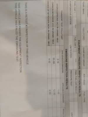

Hello, This is my first post as a day 3 SHO owner, so its sad to have to introduce my car in the emergency help section...
I have a 1993 SHO Automatic with the 3.2l and just went to have emissions done to register the car and things went horribly...
Here were the first set of results...
Hydrocarbons (g/mi) 4.02 where 1.00 is max
Carbon Monoxide (g/mi) 94.55 where 12.00 is max
NOX (g/mi) 5.14 where 2.5 is max
After getting these rather discouraging numbers, I went home with much worry, once home, I realized my CIL had come on so I ran the code which came out to be #332 Insufficient EGR Flow Detected. I then immediately realized that my green vacuum line running to my EGR valve was disconnected from the (not sure what it is but its got a red wire running directly into the manifold and the green one to my EGR valve). So, I plugged it back in and thought "Aha, gotcha!" Little did I know, I did not indeed "gotcha".
Second set of results
Hydrocarbons (g/mi) 3.33 where 1.00 is max
Carbon Monpxide (g/mi) 65.58 where 12.00 is max
NOX (g/mi) 4.75 where 2.50 is max
Im pretty sure those numbers mean I am running super rich so I was thinking O2 sensors, cats, MAF, busted Fuel Pressure Regulator Diaphram, and the usual stuff, so before I go diving into unnessecary repairs, what do you guys think is the issue here? Thanks
