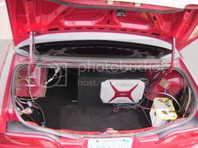

hey, here you go
IMG 0204
its the lowest hitting bass i have ever herd, but i dont like how much room it takes up, but you can hear me coming from a very long ways away if thats what you are going for anyways theres some pics.
by the way, Kicker 18" comp VR, with a sony xplod 1000 watt amp (dont think it puts out 1000...)

SlowHeavyObject said:
@dmoo21
why the yellow top? are you using it as a cap? damn sony amps...
ya, pretty much, it came time to replace the stock battery so i just decided to go with the yellow top because it helped with the light dimming problem and its a awesome battery in general
-Dan

dmoo21 said:
hey, here you go
IMG 0204
thats a nice setup ... what sice cu. box is that and what dimentions did you use ?

its 23x23x13 outside dementions, .75 inch MDF so interior dementions of 21.5x21.5x11.5 if i am remembering the build correctly. so cu. ft. would be around 3.07631655 minus the volume that the sub takes up, but that gets really complex, so go with about 3.1 cu ft. box (sealed) wich is very very undersized for the sub itself. but it hits hard and i still have a little space left for stuff.

As you can see there's room for an 18, but the trunk isn't tall enough to have it mounted vertically.

i tried lots of differnt things to get it to fire towards the rear, but k-dawg said it, too tall, and if you had it in a angled box, that would look crappy cause it would be like a 30 degree angle or something stupid like that. by the way, use something on that rear deck carpet cover thing if you have a sub pointing up. it blows around in the air movement if you dont and rattles endlessly...
