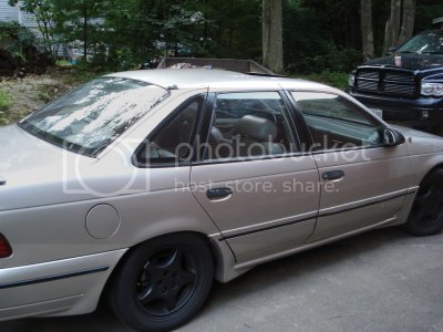

Duplicolor gloss black + SEM clear makes shiny mirrors and door frames.
Bye bye dull'd/sun'd plastic.
:naughty:
Donno if its gonna last but , at least it looks better for now.

Very clean. good job. Not crazy about the 3.2 decal though.
Thanks
Looks good, tint would help if it's legal.
Yup its underway , with a dyno run. The front sides are pretty much illegal (not really but you just add 10% and you're out of range) and the rear and rear sides , I can paint them , theres no restrictions on these , so Tints will be there soon :p

not a fan of black mirrors unless the car is black,or you have tint. otherwise i like mines body color :cool:. you did a great job though.

How did you tape the rest of the car off? I'm trying to get a feel for how lazy I can be while doing this.
I removed the mirrors (Yes you need to remove the whole int door panel.) , for the pilars I only used green masking tape (less sticky) and paper to cover the area. Be very gentle with the spray...more thinner coats>thick coats

plus tint will make it look even better. i did my mirrors but havent gotten around to doing the pillars yet. i prefer a flat black, they were that way from the factory.

do you think this could be done on car with the right taping off? or can someone give a hand with how to get the mirrors off?

You can tape it off , if you take the time to tape it really carefully , you will get good results.
HOW TO REMOVE THE MIRRORS:
all you need is a phillips screwdriver and a ratchet with 10mm socket.
Remove mirror cap plastic , one screw.
Remove 2 screws , one above the "thrash bin" of the door , one in the handle to CLOSE the door (not the one to open it) , Then pull the whole plastic piece towards you , it holds only with plastic push pins. Once done pull it towars top to unhook the door lock pin.
I let it hang by the wires but you can unhook them if you like.
Then remove speaker 4 screws. Disconnect the electric mirror connector down below IN the door (windows up). Remove 3 10mm nuts behind the mirror , you might have to tear a plastic thats in the way , if the plastic is already torn , it means someone already played there before you :thumb:
