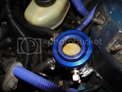

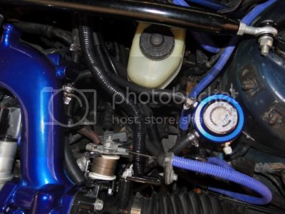

Sorry for all the V6 content, but I am a V6 guy.
Anyway, catch cans are a good idea on any car, especially the V6 that doesn't really have a functioning PCV system to begin with!
This one shows where and how the catch can is mounted on my wife's car (yeah, the cruise control is gone and this takes its place)
DSC016811280x768
And this one shows what would be collecting on the inside of your intake.
DSC016831280x768
Poopy!
On topic content: The Yamaha V6 is not really any different than the TT V6 in that this shit will get into your intake. And it is nasty, as previous pictures have shown. The catchcan I bought was maybe like $35 or $40. No, it doesn't do some of the fancy stuff others do, but as you can see it works just fine in collecting stuff.
