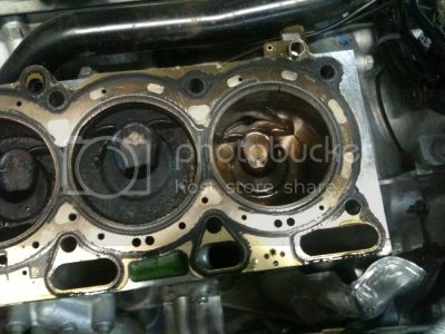

2010 Sho with 21k miles. Its not official, but i am going to be offered a 2011 engine block replacement. This is the first piston issue being reported (in the southeast) i am told by ford. And here are the pics. (iphone pics)
i had zero after market additions.

Wow that sucks. So what happened? Were you doing some spirited driving when that happened?
And Why did they just let the brake calipers just hang like that?

Oh, that hurts.
I am amused that when I have a problem, I am always told that I am the only one in the world with the issue, too!

It was just Thursday afternoon going 55. I do live in SC, so it was about 101 degrees out. I initially thought the trans was going out, it was very jerky! Then i saw the puff of smoke from the exhaust. So now i just wait and see...

That really sucks! & no mods at all? WTF? Are you really going to sell it now?!? I guess a tech's gonna have a fun day on Monday huh?

I will look into selling it when i get it back. Only reason is because i want a bigger vehicle. I am more concerned about the value now? I am not sure what to expect yet. I am just bummed about having to cruise in crappy rental cars for a month!

That's probably cool how they just let the calipers hang down like that, I bet that won't hurt them or anything.
On a more serious note, I'm willing to bet that the intercooler was unable to handle the 100*+ temps and let the charge temp get too high. But that's just my uneducated, non-engineer guess. Cool that you got a new engine, though!

Hey SHOsc, did Ford ask you any questions in regards to any mods on your car or did they just take it in without question? And I would have to agree with Hawkeye on his scenario of what may have happened. At least we are finally able to see one that has gone "Ka-Plunk." A sad site though nonetheless.

He's already stated that he's made zero mods to the car, and frankly, for the demographic the new SHO seems to be appealing to, that would be the norm, not the exception.
Of course, the "old" SHOs, being (after inflation) ~$45000, would have been much the same way for at least the first few years.
I'm willing to bet this TSB involves lowering boost levels at high ambient temps...
