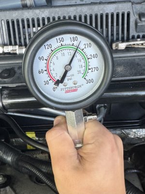

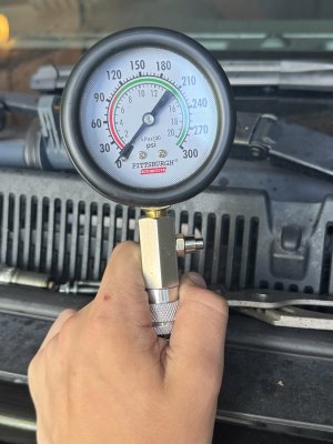

We did a compression test on all cylinders, all were good besides cylinder 3 (misfiring cylinder) showed a value of like 2. We advanced the engine with the valve cover off, the camshaft lobes are moving and in good condition. The exahaust valve tappet were moving up and down. Any suggestions on what to try? This is a piece of debris found near the tappets, not sure what it is.1750890333472

For clarification we checked all the cylinders and it appeared cylinder 3 had near zero compression.
Cylinder 2
IMG 2397
Cylinder 3
IMG 2399
Cylinder 2
Cylinder 3
Thats good if its near zero, usually means its a valve no fully closing. When i scored my walls and had a dead misfire i still had upwards of 90psi. Remove the intake manifold and manually clean the valves with crc gdi intake valve and turbo cleaner spray. It works better visually than anything else on contact. Another easy way to tell if its blowing past the rings is run the engine at idle with the oil cap off, if you get oil on you then the rings or wall is bad and all that compression is going into the crankcase
