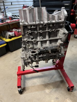

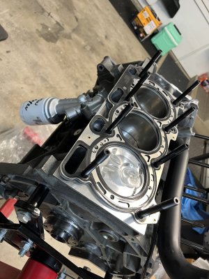

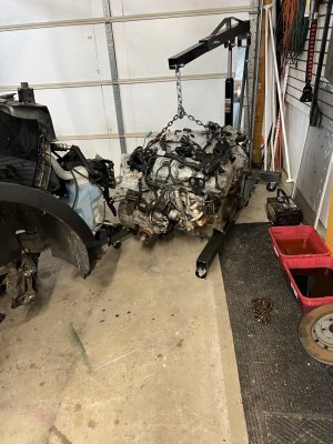

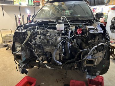

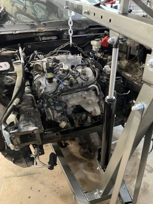

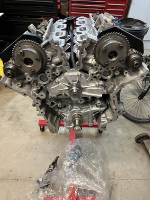

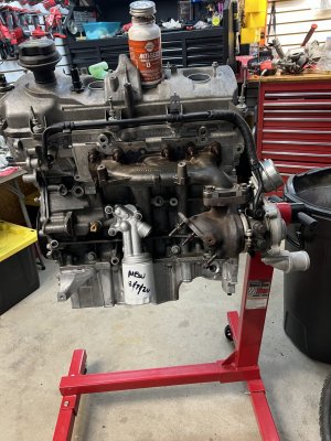

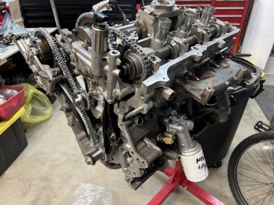

Little update…

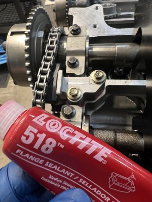

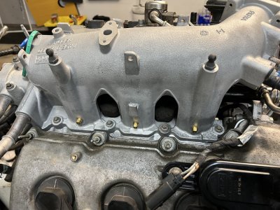

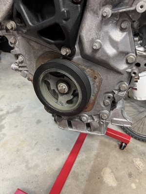

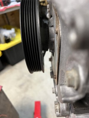

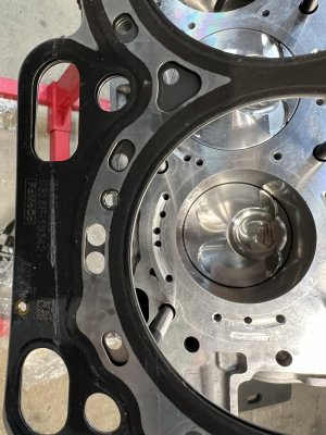

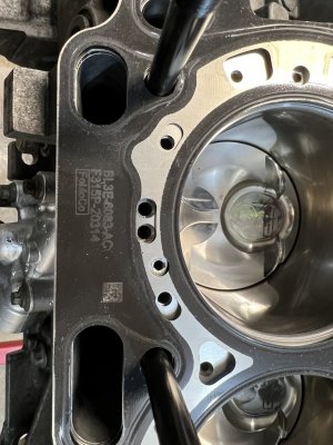

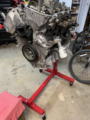

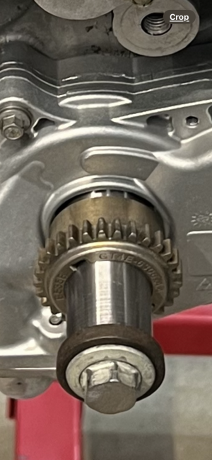

Cover, pan, rear main seal installed. Lighten pulley bolted up

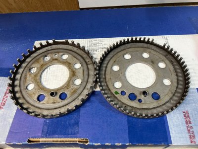

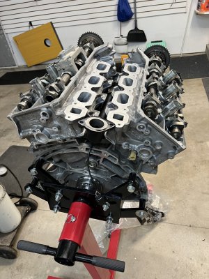

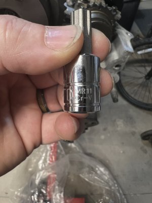

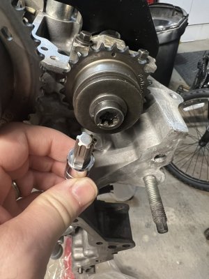

Awesome, learn new tools everyday...
Tools for this engine
Cam hold downs
Ribe m11 for the cam bolts
Powered caulk gun
Torque wrench -inches and feet
Deep 12 point 14mm for the ARP hardware
Longer than stock crank pulley bolt to suck it down
8mm,10mm,13mm,18mm
Kind of a simple engine once the machine work is completed

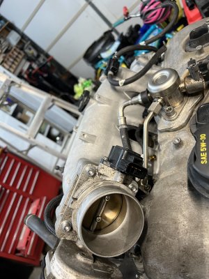

Extras include a 2nd core engine (newer) to steal the big boy timing hardware from.
Two become one…

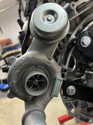

Missing a few things for the turbo lines. But mostly ready to find a new home

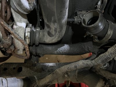

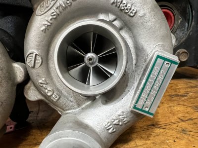

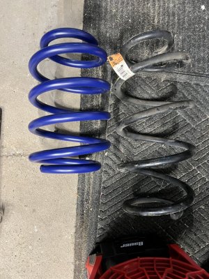

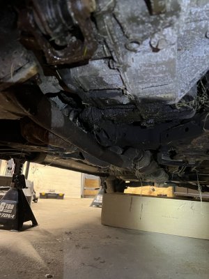

Explorer has 255k on it. So it’s getting the updated treatments
Rebuilt trans 0 miles
Tcase 16k
Rear carrier 41k
Fun engine build 0 miles
H&R springs
New struts/shocks
Cvf intercooler
New radiator and condenser
New hose etc
Reviewing and replacing as I find more stuff

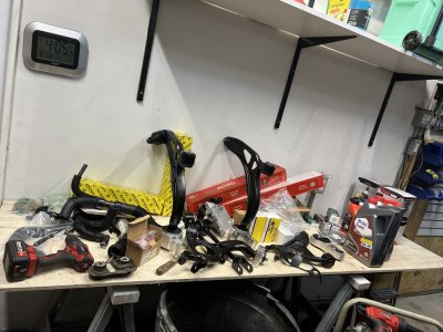

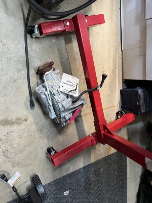

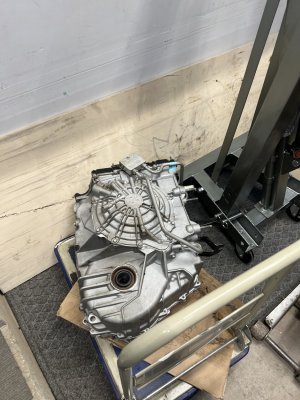

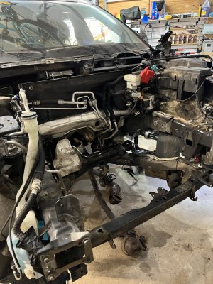

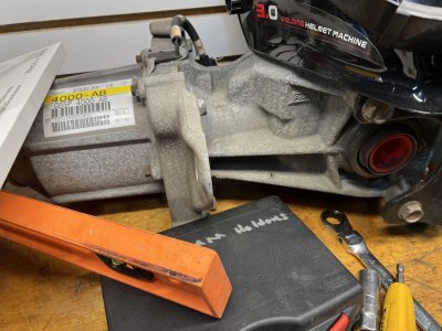

Ran into a snag, the trans for the flex.... is a 2 year wonder... so the water cooled ptu is not sliding in. Looks like I have a rebuilt trans to sell, and a different trans to install....

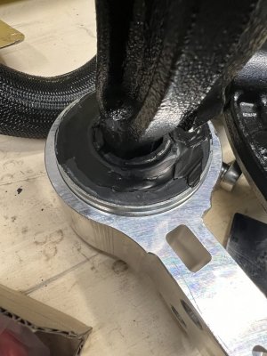

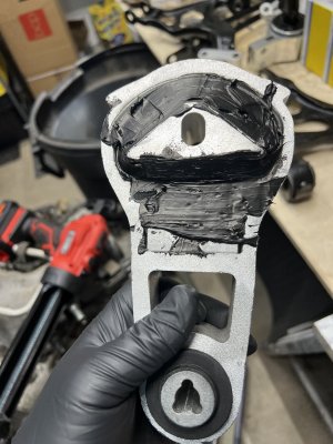

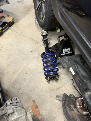

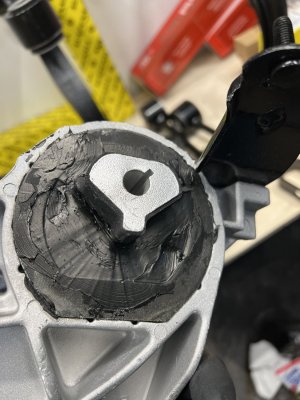

Adding windshield urethane to all of the bushings also found a new style dog bone added urethane to that as well. I have the Anthony mount style on my flex, trying this out before swapping over.
Updating all of this suspension.
Ended up grabbing a younger transmission, PTU, and rear carrier
Updating the radio Apim to an “All things sync” unit to add carpart to the factory setup. Don’t plan on updating the audio - unless the speakers are toast.
