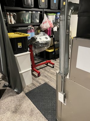

Well the winter project is heading back into winter again.....
The new shop completed the crank, after balancing the old crank to understand Ford, He had to add weight to the new crank, polished it up, weight matched all the rods, and matched the wrist pins to the pistons to create a matching weight combo for all of it.... Guy really invested some time to make sure it was spot on!!
But he doesn't have the time to build the bottom end for me...
The block was left at the old shop, so I stopped by with everything and to my surprise the deck surface was cleaned up and ready for assembly.
Again told him to take his time...
As for the car.... it's not going in this Flex... sadly Michigan is not nice to cars and this car is rusting out... end of an era for it. I been looking for a new chassis - something with a blown engine (they're out there lol) but also eyeballing a Explorer ST - might just be building an engine to build an engine.. time will tell.
