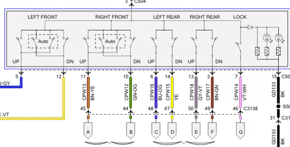

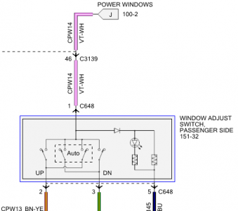

Likely a bad master switch or loose or broken wire. The power to the other 3 switches goes thru the lock switch.
