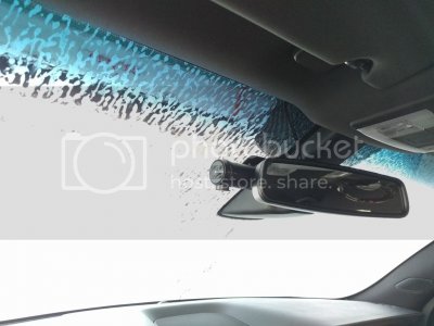

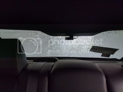

I have a blackvue dr-650s2ch running the rear is a easy just need to pop the rear seat forward I think all the panels pull off without unscrewing anything
WiFi I great so you can check on it periodically and so it can send alerts when someone has ****** with your car when it's parked
https://www.amazon.com/gp/aw/d/B01H...dr650s-2ch&dpPl=1&dpID=31rNCKOajSL&ref=plSrch
Sent from my Nexus 6P using Tapatalk
IMG 20160510 122036 zps3cdytwiu
IMG 20160510 122020 zps5myzvroc
Like the frame rate on that nice and smooth not like some. Clear at high speed.

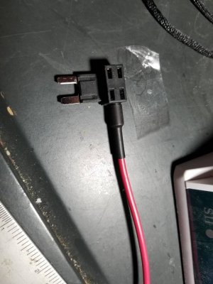

I also purchased the Blackvue DR650S-2CH and am happy with it. The kit I purchased from Amazon had "add-a-fuse/fuse taps" included. However, It doesn't appear that it's long enough to fit snuggly due to how the fuse box on a 2013 Taurus SHO is molded and has a cover. Has anyone been able to find an add-a-fuse/fuse tap that works in the 2013 Taurus SHO?
Using this on my 2015 as mine was not long enough either, using for my redline radar dector 86421130b70a73b0be9a15e657bad937

Thanks for replying and sending a photo. My 2013 Taurus SHO uses low-profile mini fuses. The blackvue kit shipped with the low-profile mini fuse (APS) add-a-circuit and it doesn't have enough clearance. The photo that Sholab 1 posted is of mini fuse (APM/ATM). The mini fuses worked for me as well!

Rear view question, how is the view out through a tinted window? Is the cam degraded at all?
