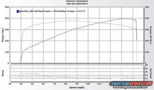

One reason I want to use the whipple charger I have saved to install on the SHO is for the better torque curve you get with PD supercharger. For example:
Stsv final dyno run
Boost right away and stays there.
