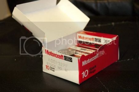

I went to the dealer several years ago and had them do a nationwide search for the AGSP32PP, and I got a dozen and a half then mailed to me from the the only dealer that had that many in stock, and I still have 6 left new in the box! Jealous? :sun:
