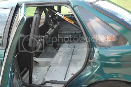

It's called a back seat for you, my SHO doesn't have a back seat. It's built to haul a** faster than your SHO will ever see. And yes, this is probably why my cabin receives vapors.
Hey, I don't have a back seat and I have a FP door!
Weight012 1
My SHO is also built to haul ass and faster then both of yours. ;)
My fuel vapors are not caused from anything other then the car running so rich at all RPM's that it will choke you if your standing near after a few minutes at idle. w00t.
