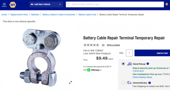

Those terminals are meant to be temporary. I know people install them and forget it. They will always cause problems later on.

In any sort of humid environment they are about guaranteed to corrode and grow powder, sometimes off-white, sometimes with a green tint. Any time someone asks me about a no-start or weak start condition, these temporary terminals are one of the first things I check for. I'm glad I'm not the only one who grew up trained that these are expected to be temporary use.

i once had terminals replaced by a firestone service center. lasted years, no corrosion. have to use terminal protector tho, no matter oem or aftermarket. especially on standard flooded batteries. agm is almost never an issue.
