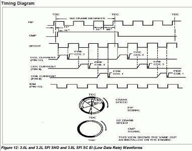

Here's a diagram of the SHO coil timing.
V6 timing waveforms
The 3.0L and 3.2L SFI SHO and 3.8L SFI SC EI (Low Data Rate) Ignition System ( «Figure 11») consists of a crankshaft-mounted hall (PIP) sensor, a camshaft-driven hall (CMP)sensor, a 6-tower coil pack, and an Ignition Control Module (ICM).
The Electronic Ignition (EI) low data rate system eliminates the distributor by using multiple ignition coils. Each coil fires two spark plugs at the same time. The plugs are paired so that as one fires during the compression cycle, the other fires during the exhaust stroke. The next time the coil is fired, the plug that was on exhaust will be on compression and the one that was on compression will be on exhaust (the spark in the exhaust cylinder is wasted but little of the coil energy is lost). Three coils are mounted together in a "coil pack". The coil pack has three coil wires, one for each coil. The crankshaft sensor is a digital-output hall device (PIP) that responds to a rotating metallic vane mounted on the crankshaft damper assembly.
The 3.0L and 3.2L SHO CID signal is generated by a hall device mounted at the end of the rear camshaft. The vane cup has one tooth and is driven by the camshaft. The 3.8L SC camshaft sensor is a hall device, but it is mounted in the normal distributor location.
The PIP output is a 50-percent duty cycle signal that provides base spark timing information. The CMP sensor signal output is also a 50-percent duty cycle signal, and is required so that the ICM knows which coil to fire and for fuel timing in the PCM. CID is high (B+) half of the cam revolution (180 degrees) and low the other half ( «Figure 12»).
The PCM determines spark angle using the PIP signal to establish base timing. SPOUT is sent from the PCM to the ICM and serves two purposes: the leading edge fires the coil and the trailing edge controls the dwell time. This feature is called CCD or Computer-Controlled Dwell.
The Ignition Diagnostic Monitor (IDM) is an output from the ICM that provides diagnostic information concerning the ignition system to the PCM for self-test and is also the input signal for the vehicle tachometer. If the CMP circuit fails and an attempt to start the engine is made, the ICM will randomly select one of the three coils to fire. If hard starting results, turning the key off and then cranking again will result in another "guess." Several attempts may be needed until the proper coil is selected allowing the vehicle to be started and driven until repairs can be made. The Failure Mode Effects Management (FMEM) system attempts to keep the vehicle driveable in spite of certain system failures that prevent the PCM from providing spark angle or dwell commands. The PCM opens the SPOUT line and the ICM fires the coils directly from the PIP input. This results in a fixed spark angle of 10 degrees and fixed dwell.

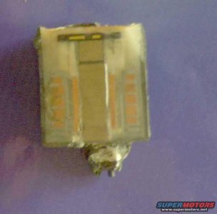

Here is a picture of the V8 COP cut in half. You can see the windings.
Cpp cut open 4
