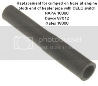

Cut the crimp off, and then you can pull the bad rubber hose from the metal tube. The diameter of the outlet on the engine and the tube are different, so you need this part, which you trim to the length needed to replace the bad rubber piece. Secure with worm clamps.
SHOcelopipeheaterhoseNAPA10080Sm 1
:thankyou::thankyou::thankyou:
I have been dealing with this issue forever! I have been stretching the smaller diameter hose over the metal tube and having to replace it every couple years because it stretches and breaks... I feel like an idiot - didn't know these were out there.
