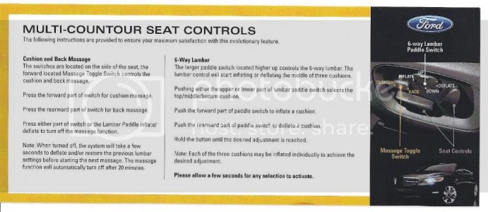

Here's a scanned image of the dubious laminated card that details the "how-to" on those multi-contoured seat controls.
I've received two of these thus far myself......
Hope this de-mystifies the day to day operations of our fancy seat controls :thumb:
Boy, you must rate. Getting 2 of the cards, I never received any of them. However, after a lot of goofing around with the buttons, I think I have my seats all figured out, although there are still times they inflate and surprise me. Every time I unlock the car and open the door, I can hear the compressor running, but normally it's the passenger side seat that inflates the lower back. I will have to reset the memory on that seat, I believe my wife set it for her favorite, but it could have been on of my friends...one of the few!
Multi ContourSeatInstructions
For those of you that desire to see a larger image other than the one posted directly above, below is a direct link to the image itself.......
http://i229.photobucket.com/albums/ee231/bpd1151/Miscellaneous/Multi-ContourSeatInstructions.jpg
Thanks Mike, unfortunately this has not provided me the info that I wanted. I know how to use the lumbar controls and the massage button. What I was hoping for was some instructions on how to change the actual pressure of the massage in each bladder. I find the massage to be too weak in the lower back and that's where I need the most pressure. Being 6'8" ain't easy on the ole back :frown:

The inflate and deflate buttons still work during the massage function. When the bladder is massaging that you want to inflate more, press and hold the "inflate" button.

Really? Everytime I push the inflate button while the massage is working, it turns off the massage......
I'm going to have to go try that again just to be sure

Are you pushing the "Inflate" button, or the massage button? Inflate is part of the 4-way toggle, not the rocker switch.

Yes, I'm using the 4-way switch to inflate. Just tried it again while driving home from work and when I try to inflate, the massage stops.... I can inflate the lumbar when the massage is off and then turn it on, but it seems like it resets to the normal lumbar inflation.
Basically, I want to inflate the lower back bladder to the maximum inflation while the massage is on. I know how to use all the switches but I can't seem to make it work
