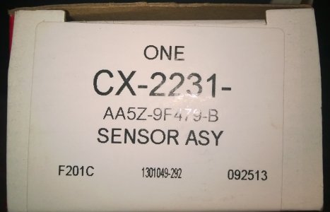

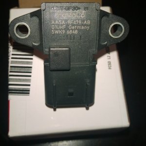

Here's what the 3 Bar pkg should look like:

Where do I add the 3 BAR   Intake Manifold
