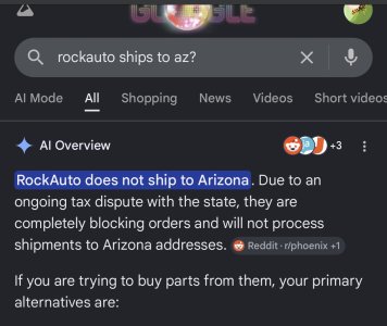

Majestic
Aug 28, 2016
1,275
1,021
Available on Amazon. If you really want to go the RockAuto route, you can order it, ship it to me, and I'll mail it to you if you'll cover the shipping, which should be like $5.
