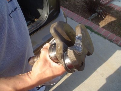

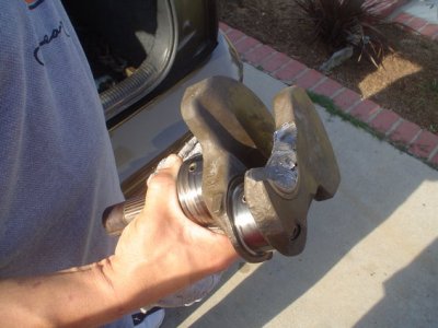

Broken snout?! That's crazy.
Dsc02862
I've had the SS UDP on my '95 for a couple years now, so far so good.

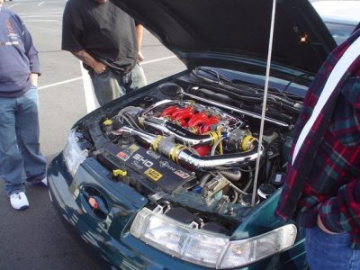

What's that from? I assume a SHO, but FI, stroked?
Dsc02862
Judging from where it broke im guessing its like the few others that broke the crank due to being cut.. cut the hardened layer off.. its right at the radius filet
Like a chain being only as strong as its weakest link. . When you remove hardening and undercut the radius due to bad rod bearing the radius is the weak point as all the stress gets put right at the tight radius .. sorta like taking a saw blade with the circle cutout between the teeth and making it a sharp 90 or 45 or whatever. . Once the tooth of the blade hits a tough spot it would likely shatter the blade
What is that from? Not a pulley right?
Just an SC, bottom end was stock IIRC. Went to a 3.2 after that. The car made it to a few conventions before disappearing.
