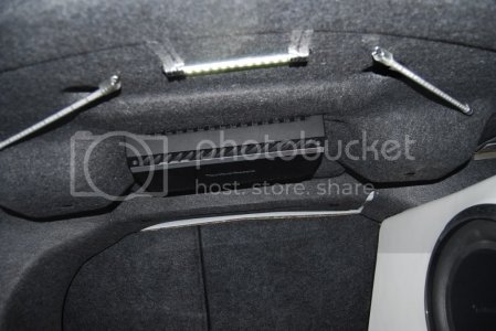

New amp mounted upside down on the roof of the trunk
5b7aa311
Wires tucked nicely

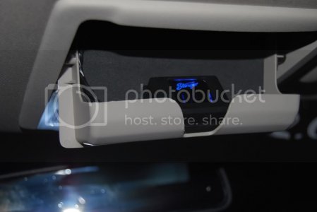

Temporary spot for the voltmeter (thats where I am keeping it, just not finished mounting it)

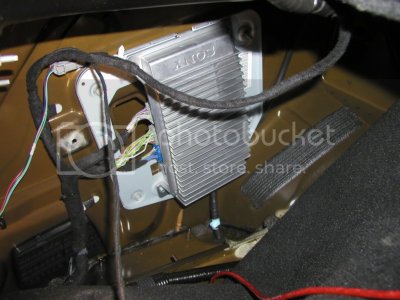

You wouldnt happen to have a picture of where it is would you? I think they must have chaged that whole setup on the 2011's... Below is what mine looks like (stock).

You dont have the Sony sound like I do. I have a big stock amp and then a digital audio controller.
See the top amp marked sony and the processor on the bottom.

But I do...
Strange... :shrug:

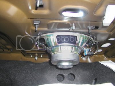

Wtf thats odd. You are missing the amp for the two "subwoofers."
AUDIO11
You are missing this box
[/img]

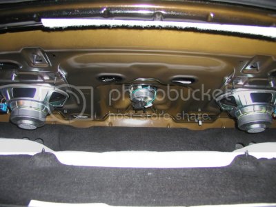

Im sure your not actually missing it they probably moved it somewhere else, but if you pull down the roof of the trunk (its just velcro) you will see the two subs. Follow the wires and see where they go. I have a 2010 so the amps and DSP box are next to each other.

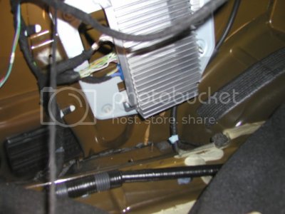

The red wire is my RCA cable, I already had the subs/amp put in but i was using the ground you can see in the pictures next to the amp where its been sanded down. It worked at low volume but when you turn it up where the power really starts the amp turns off because it isnt a good ground.

If you look on your picture of your amp I used the bottom left bolt on the bracket holding the amp to the car as a ground. Can you put up pics of your subs?

I dont understand. Where do the RCAs go? Those are the factory subs, I know they are there lol. Take apart the other wide of the trunk and see whats back there I guess. That other box is where you have to tap off of to add subs.

Adding the additional amp is a huge improvement with the new speakers. Coming from a 200 watt stock system with some crappy 35w Sonys to true components adds so much additional sound. Definitely a recommended upgrade. The second amp tucked nicely on the roof of the trunk too.
