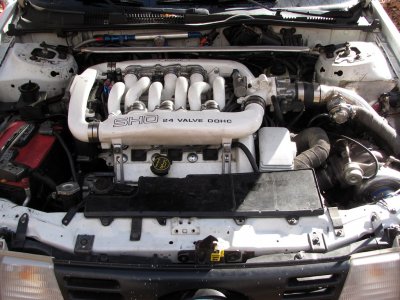

Turbos that have been done or still running?
Btw I had a 50 trim with a stagev wheel last year.
100 1651
It didnt make good power up top at all, but it was fun to drive around town. Just go with a bigger turbo. Turbos dont get much more expensive in size.
