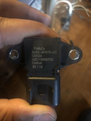

What MAP are you switching out? The one before the throttle body, or the one on top of the intake manifold?
7,399
9,697
Verify you have a 3 bar map sensor for the top.
13,265
Did you go back to stock tune without changing the map? Confirm the part number if it's a ford part

Yep definitely a map sensor mismatch. Common symptoms. Email them to verify the tune.
13,265
I don't own one so I'm not as up to speed on all the part numbers, but I think that is correct for 3 bar.
