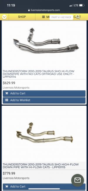

I started out my journey with L...shit and I only paid 1,000 for tune, device, plugs, t Stat, 3 bar and plugs. I bought the catless downpipes so I'm like about $900 less than you. Last thing I got from them was rhe Alky kit. So for $100 more than you I also had meth injection.
Next big jump in power will only cost you about $600. Sct device and custom tune! Like some on here, you get a rush from razor blading Livernois Motorsports OFF your windshield.
