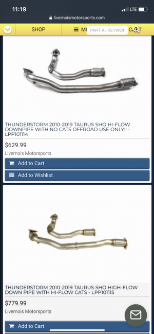

Correct about re-branding Down pipes are rebranded "American Racing"....damn I hope I just didnt waste $2,500
I mean... I wouldn’t say wastes money... you got downpipes, cai, tstat, plugs, and tune right?
Not bad.
Oh. Em. Gee.
$2,500 for (rebranded DP's) !?!?!?!?
I just vomited a lil bit for you. Dear God.
Run. Run while you can. All of us can't stress this change alone. Your SHO and your wallet will thank you for heeding our advice and doing so.

Oh. Em. Gee.
No way....

Oh lord no, all in for every thing!
