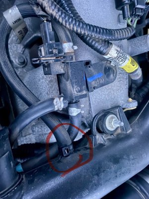

And it kinda lags. Rpms do bounce. But if you punch it it pulls thru it. Worse at a start tho. Almost feels like air leak ? Gas issue or something. Definitely losing power as I accelerate

If you haven't already check the ziptied hose in the attached. Top of engine on right looking at it from the front1780885392830
