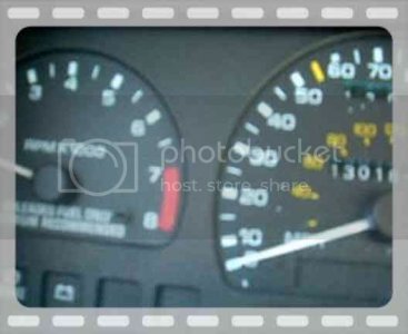

Sounds like the same thing you went through in this thread, Eric V. Here's a little video I made of me at first taking it easy and then getting on it on an on-ramp.
Th 001 1
The noise is present in first through fourth gears, and then disappears entirely when I get into fifth. So it must be an internal transmission issue, and it can't be the differential since it disappears in fifth. I know it's pretty much shot now, but I'm curious if anyone has any ideas about what it is inside the tranny that went bad. I'm thinking bad bearing, but would stripped teeth make a noise like that?

Ok here's how it went away for me and what I changed. I pressed another bearing in after I found that one.. and its still making that noise. (also still a good bearing when I pressed this one in myself I wont pay for anything anymore) Noise was still there... so I found a spare transmission, and swapped my old one out. I still haven't gotten my old one rebuilt yet but I would assume its an input shaft bearing. Haven't heard from Bizzy in a while, but I'm sure she'll see this thread eventually. Whatever it was she told me it sounded like is probally what your is doing. sounds very very similar.
I checked for any kind of wear inside the bell housing or for loose bolts on the PP but everything looked ok. For diagnosis sake I didn't even try to tighten anything else up. I did however when dropping the subframe replace the sway bar bushings with polys, and the front strut rod bushings with polys, but don't think those played a part. But I don't have the noise anymore so it was definately in the tranny.
I havent cracked it open yet, but when Bizzy gets a chance to fix it for me I'll let ya know. I didn't want to lose any evedience or disturb anything she might be able to see.
See if she can get yours fixed by first, mine is doin ok.. just got a crappy 2nd gear lining and I grind second if I am not cautious with it.. I got other things to replace currently. (entire suspension)
Also IIRC it was a pretty bad idea to drive it sounding like that. Something is probally making contact with the housing.. not a good thing. :( sorry for the bad news. Good luck!

It started before the accident.
And, at least in my case, it wouldn't have anything to do with the bellhousing/pp/flywheel/etc. It completely disappears in fifth, even when I shift into it going relatively slow to keep other road noise to a minimum, say, 35ish. In all other gears it's very audible both when I give it throttle, and when I'm engine braking, with a little spot inbetween where it doesn't do much at all. So basically, it does it when it's under any sort of load.

Yep same thing. I could have it in the other gears but just even out the engine speed / pedal so there was the least torque going thru the halfshafts it would be almost non existant. If the pedal went down, or up a little more it was loud. I couldn't hear it in 5th either. FWIW.
