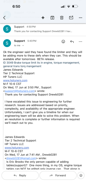

Rev9 Update
Back in HPTuners I did another crank relearn in Forscan bc I’m unsure it stays intact flashing back to stock calibration. The car felt great and it pulled the best so far.
After reviewing the log and talking with Ryan, I’m increasingly convinced Rev9 was intended as a systems validation run rather than a power tune.
The previous Brake Torque Limit was increased from the stock 500 Nm value to 881 Nm (650 lb-ft) and the results were immediate.
Peak values from the run:
-Desired Brake Torque = 650.0 lb-ft
-ETC Torque Request = 650.0 lb-ft
-Scheduled Torque = 696.7 lb-ft
-Engine Brake Torque = 433.5 lb-ft
-Actual Load = 1.922
-Desired Load = 1.921
-Airflow = 55.2 lb/min
-Boost = 18 psi
The interesting part is where the torque sources changed.
At peak torque, Torque Source still showed Engine Speed Limit while the PCM was requesting 650 lb-ft and scheduling nearly 700 lb-ft. Later in the pull, once actual load exceeded the current torque model range, Torque Source changed to Engine Indicated Torque Limit.
That appears significant because the current torque model effectively tops out around 1.9 load and the car reached 1.922.
One thing that immediately stood out was the fueling. Lambda was down around .72, which is extremely rich. On a power tune I’d normally expect the conversation to be moving toward .80-.82 lambda, not .72.
The fuel system was intentionally given an enormous safety margin while we verified that the new brake torque limit changes worked, verified fuel pressure remained stable, verified the injectors and HPFP were happy, verified boost control remained stable, and verified that the car could move beyond the previous intervention point without setting DTCs.
The result was exactly that. No P0219. No DTCs. No positive knock observed. Fuel pressure tracked. Load tracked. Boost control remained stable with WGDC still relatively conservative. The previous torque ceiling appears to have moved and a new torque source was identified.
What’s even more interesting is that Johnny Powers at HP Tuners is already looking into the next bottleneck. He personally wanted an update and I gave him one on Sunday. I told him the Y axis in Indicated engine torque cannot exceed 2.0 load. First he wanted me to check with Ryan, under advanced access if he was able to access editing load above 2.0 and Ryan thankfully was available Sunday and reported no. Johnny said he’d have it editable by mid day
It sounds like this may ultimately become an Advanced Access feature where users receive a warning prompt before extending the torque model beyond factory-defined limits.
If that happens, Ryan should be able to properly extend the torque model rather than operating at the edge of the factory calibration range.
We’re also investigating rear drive unit clutch duty cycle control similar to what exists on later SHOs.
My friend David brought up a calibration he performed on a 2016 SHO where rear differential clutch duty cycle was controlled by throttle position, vehicle speed, and gear. According to him, that single change dramatically improved launch performance and reduced both 60-foot and quarter-mile times.
His comment was: “**** should see if we have the ability to control the rear differential clutch duty cycle. That one table alone had my buddy’s 2016 I was tuning in stock wheels and tires cutting a 1.6-1.7 60 ft and 11.5 1/4 mile on the street. Ya it allows u to control the lockup clutch duty cycle and axis are TPS vs vehicle speed by gear.”
Johnny is currently investigating whether similar functionality exists within the 2010-2012 Green Oak strategy. Or he mentioned, “
So the older cars might have been controlled by another module for the diff? Yeah if it’s hard coded I might be able to do a patch to increase it. But we shall see.”
One thing that has become increasingly obvious through this process is that there are still capabilities buried inside these older operating systems that were never fully exposed. Every time we remove one ceiling, we discover what the next ceiling actually is.
Johnny also made me laugh with this comment: “lol. Good luck with stuff like this for GM and Dodge..Only Eric and I care about the masses and not just big name tuners.”
I humbly recognized how rare this truly is. I told him, “Yeah I know this isn’t normal, I truly appreciate what you’re doing.”
For now Rev9 looks like a successful systems check. The previous brake torque ceiling moved. The car reached 1.922 load. The PCM requested 650 lb-ft.
A new torque source appeared. And we now have a clear direction for the next phase of torque model expansion.

It’s happening today. From Johnny: “I got it. dont worry.. now more than likely he will have to change ALL of the load axis's to the same.. if one axis is set to a lower limit NORMALLY it will use the lowest. but i changed alot of the axis's and i updated a few little things for now.. once we break past that load limit ill start updating other things and finding stuff thats not in there.”
What!?! This is insane! I asked if this required Advanced access and he said: “Naw won’t require anything special.
Next beta later today will be good to go.
I set all max load axis to 5.0, shouldn’t need above that lol.”
This is absolutely insane!! Unlocking my OS with its own abilities, just dormant and overlooked for over a decade.
Over the weekend I looked back over my full D I c k passes in SCT and even though I did make more than 2.0 load, peaked 2.2…I hit torque source 16 which is indicated engine torque limit. Also torque source 4 is engine speed. So these aren’t new. I think SCT’s limit was 2.0 load. Like you can make more but it’s off the torque model map so it acts weird, strange interventions. I was able to look with a new perspective at this logs. In my fastest no nitrous pass it ran clean, but with nitrous it hit over 2.0 load and the PCM lightly intervened. Essentially nitrous pulls were handicapped by the PCM. They could have generated more power if the torque model was scaled higher.
I’m more pumped than ever right now. Johnny has taken a personal interest in the Platform. Specifically 10-12 but he’s interested in other models.
