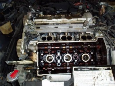

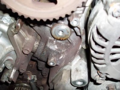

Here are some pics.. i found the pully but it wasnt the right one..
P8230300
P8230299
P8230297

can someone plz help me find this pully..if not can i match it with something else?

You'll want to go to the WTB (want to buy) section of the forum. Their are several stickies on the top of the section with vendors that have a ton of parts cars and they will be able to get you that pulley no problem. You will also want to check out the 'parts cars' section for that pulley and their is also a classifieds right now for parts from NE sho specialists that i'm sure will have that pulley. The parts are out there you just need to be a bit more proactive.

Also, you might want to invest in some AutoRX the internals of that motor are nasty!
I'd put rod bearing as a top priority.
I also just noticed that you still have the serpentine tensioner on the motor...why?

Is that crank cancer I see??
Also...Those heads look like they are CAKED with oil buildup and deposits. I dont know what would clean them up, But anything is worth a shot

Also, I see oil still left in your plug wells....I hope you drained the majority of it before you pulled the plugs so that the oil/dirt/grit...and what not didn't drain into the combustion chamber.

Good Lord, that poor motor! That's one of the most discolored heads I've seen on a SHO.

well..now you see what i have to work with..lol thanks for the imput guys..this car is quite a project! may i ask whats crank cancer?

Well, for one thing, but looking at those pictures that engine has had a long hard life. I'd be putting rod bearings at the top of your list. How many miles are on it?

i dont remember where i seen pictures of crank cancer but search the forums i know its there somewhere with pictures or a link to pictures on crank cancer. from what i can see it dont look like crank cancer but i cant tell its hard to see the crank key on these pictures.
my heads on the 3.0 donor car i had were bad looking but they werent that dirty. looks like your gonna have to clean them manually with some good cleaner.
you could take the heads off and apart all the way and soak them in paint thinner from what ive heard, i dont wanna recommend it but ive heard of it being done and let it sit over night to clean all the crud off.
but remember you would need new head gaskets A MUST!
i dont know if by chance some engine clean running it threw would work or not. after you do get them clean use good oil on this engine olny to help keep the engine clean as can be.
you maybe could use some carb cleaner and a brush and work away trying to clean the heads and all up.
the intake id recommend letting them soak inside with something to clean and brush em clean.
dont use a toothbrush since they melt in carb cleaner and paint thinner etc.
good luck cleaning them.
remember harder you work the better you will rest the engine will stay for a long life.
