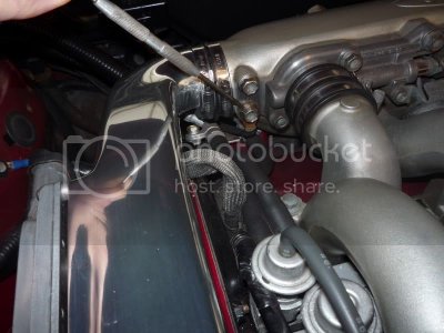

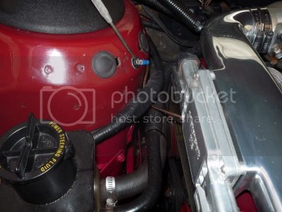

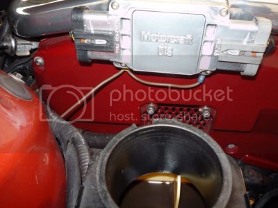

What am I going to do with you? Without the crossover tube support (not the same as the plenum surge tank supports) brackets installed, there is no way for the crossover tube to be grounded. The crossover tube MUST be grounded AND the DIS must be grounded to the crossover tube by way of its 4 mounting screws. There is no need to ground the snakes, they are grounded through the heads and block which is grounded through the black ground wire attached to the V of the block, next to the knock sensor. It would be better (if you don't want to put the crossover tube brackets) to run that flat ground strap to the crossover's mounting hole that is 2" to the left in that pic.
Grounding is very important on these engines.

& on that first pic of the stock intake the red wire you see is also a ground just for the DIS on that intake. On the polished crossover I cut off the mounts!
