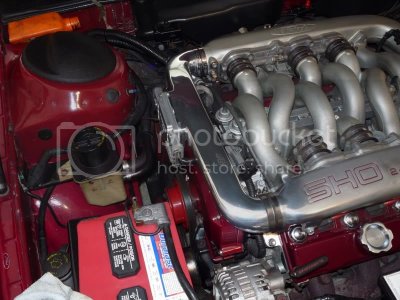

A fine job twitchblade on diagnose & fix!
-& the first pic I posted was a confirmation of what he said "twitchblade= i have the ground strap solidly connected without the support. you can connect the ground strap to any point on the engine that has a good contact to metal, not just that one point."

-Yes, again I know.:salute: & my thought on that was if I polish 1 piece & install it with the other stock pieces, that 'they' would want to be 'shiney too' & it would spread!:nut: LOL Looks like its working!
