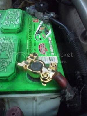

Confirmed, I dunno why but that positive battery terminal corrodes quickly after I take it off. The post was pitted from all the arcing but I cleaned it as best I could and smeared a thin film of dielectric grease over it and the inside of the new terminal. Blinged (gold plated) it out so there'd be less of a chance of corrosion, hopefully it stays clean this time. But yeah, after all that the alarm decided to let me know ALL WAS WELL right in my ear, everything started just fine, no funky blinking crap. I can only assume turning the headlights and the ignition on perhaps created a draw great enough to either make it's way around the corrosion or just made one big arc, who knows, it works now so hurray :woo-hoo:

The brass one I looked at almost looked like a brass coated lead terminal, that's why I went for the gold, it's most certainly not lead, couldn't bend it to save my life. But it went on well enough and I feel better knowing it has about the best connection I can manage to give it. Also make sure you never over tighten your terminals, every car I've ever worked on that has replacement lead terminals has them over tightened and stretched out, I could take them off without even loosening the nut. Snug is all you need, snug it down and make sure it won't turn left or right and you're done.
