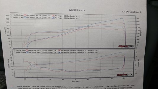

I have to agree with this... If you're wanting to do events like this or really perform when "people are watching", a turbo is going to do much better. At the same WHP that this car makes, a turbo will have a much broader torque curve, and a lot more of it... Which would have probably gotten him much closer to 120 MPH. If you want to road course a car with smooth, predictable power, the Vortech will do well.
I was supposed to have a 500whp STi that I tuned out that day too, which I was really interested in the comparison, but he ended up having something come up at work and could not make it. I suspect that car is 10mph faster at the strip.
Which power band would you rather have? :)

Jesse I’ve spoken to you about this topic before but I really want it to sink in. So I’ll try to explain again. My build goals are completely different than yours and that’s why I went supercharger. turbo makes more sense for your goals.
My build is meant to be a show car that is nice to drive on the weekends that I can have fun with and honor my family’s heritage. My great great uncle John Bandimere sr invented and patented one of the first superchargers for automotive use. During that time he worked as a traveling salesman selling and installing his superchargers before opening Bandimere speedway 60 years ago. My family is very proud of his accomplishments and because of that I have strong sentimental ties to superchargers. That’s why all of my cars have superchargers. I also don’t care if there’s cars faster than mine. I’m very happy with what I built and couldn’t be happier with how it ran on Saturday. I had a blast hanging out with family and friends plus the car got a lot of attention and I met a lot of new people. Can’t wait to run it again next year. That is what I was after and I could care less that I got beat by someone else. It kept up with all the cars anybody could have expected it to. And i still drove it to the track and back home.
If you really want a car that is going to beat any 4th gen out there and anything out on the street like you say you do, you’re going to want a turbo. Especially because you’ll have a transmission that can take the torque unlike me. With a supercharger you can make high horsepower but you don’t have the power duration that turbos do. Yes, I make 500 whp but it’s also with a lot less torque and only at 8000 rpm. Meaning any turbo car that makes even 400 whp even though it makes less peak power than me will get the jump on my car every time and I have to catch back up once I get into high rpm. Turbos make full boost a lot earlier and carry that boost for a lot longer. So if you’re serious about making a supercharged car you need to make a lot more power than a turbo one does so you can catch back up to it before the end of the race.
The race with the eclipse at the end of the video is an awesome example of turbo vs supercharger. The eclipse obviously makes less peak power than me but It got its power before me and pulled away off the line when it got full boost but I caught up at the end of second gear when I hit peak boost. Then When I shifted into third the whole thing repeats itself. it pulled away again because I was at lower rpm and not making my peak power but I caught it again by the end of the track. During that run my trap speed was something like 8 mph faster than hers but she still got away from me. Some of that problem can be alleviated with a bigger/more efficient supercharger but you will never carry boost like turbos do. So unless you make way more power than whatever you’re racing you’ll always be playing catch-up with a supercharger. It’s just up to whether you make enough to catch back up. And in my case I ran out of track.

To be fair, a few of us have already built supercharged SHO faster than any 4th Gen, just not from a dig. After doing a supercharger on my SHO, I haven't done a supercharger since. It dragged power, requiring larger injectors, it was kind of obnoxious from the noises it made, it wore my front main bearing pretty quickly, and I found myself wanting it to have more midrange power.
If you add nitrous, go with a direct port kit. Zach had a lot more flow to one cylinder compared to the others and it caused some nice knocking, as visible by the top of the piston. And that was with E85... And still the set of pistons currently in the car.
I wouldn't focus too much on that sound system. He could have removed that and there rest of the interior and wouldn't have gotten an closer to the Mustang or CTS-V.
