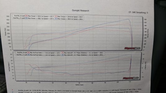

Anyone kept track of that, because this has to be up there.
1991 SHO - "Bandito"
15 psi
Vortech S-trim w/ 3" Pulley
XSpower AWIC
ID 725 injectors (Base pressure set at 50 PSI)
Walbro 460 LPH in-tank pump - Hardwired
PMAS MAF
3.2 swap with 3.0 cams
Stock internals
Ported intake
BBB
E85
