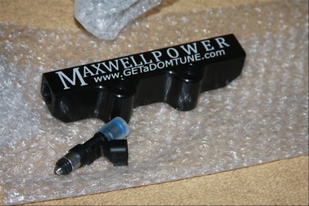

I'm putting in everything next week (remember, this is for the STi... E85 in my SHO would most certainly shred the transmission). I do not have to change the tank or the stock lines. If I stuck with side-feed injectors, I would only need to change the pump and the injectors.
Because I wanted the ID injectors, I got the top-feed converstion setup which will require me to replace the fuel rails (pictured) and the fuel line from the firewall>injectors. The DW300 fuel pump is rated for E85 and I believe the Aeromotive is as well. I know plenty of people running E85 with the Walbro 255 as well.
I will be replacing the in-tank filter for something in the engine bay. I am unsure how the stock filter will do with E85.
