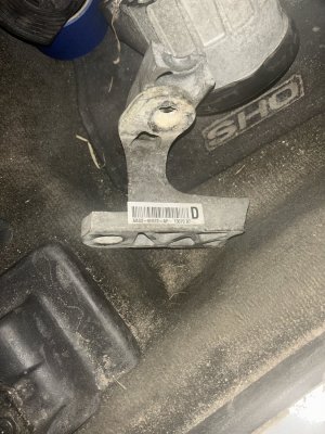

I went to the local ford dealership I ordered the new motor mount to, come to find out they ordered the wrong part. The mount is AA5Z-6038-D
They ordered AA5Z-6038-B. Thank god for overnight shipping from Detroit up to my dealer in Michigan!
This was my old motor mount:

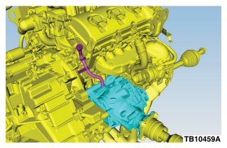

u know your vent tube could be clogged its always gonna smell. there were certain years that Ford had a tsb about the tube missing.
TSB 15-0056
04/17/15
AWD - LEAK FROM PTU - BUILT ON OR BEFORE 12/11/2013
FORD:
2013-2014 Explorer, Taurus
LINCOLN:
2013-2014 MKS
This article supersedes TSB 14-0032 to update the Service Labor Time Standards.
ISSUE
Some 2013-2014 Explorer, Taurus and MKS vehicles equipped with all wheel drive (AWD) and built on or before 12/11/2013 may exhibit power transfer unit (PTU) fluid leaking. This concern may be due to a PTU vent hose which is missing or disconnected.
ACTION
Follow the Service Procedure steps to correct the condition.
SERVICE PROCEDURE
1.Raise the vehicle on a hoist. Refer to Workshop Manual (WSM), Section 100-02.
2.Is the PTU equipped with a jiggle cap style vent assembly?
a. Yes - this article does not apply. Refer to WSM, Section 308-07 for normal diagnostics.
b. No - proceed to step 3.
3.Is the PTU vent hose missing or disconnected?
a. Yes - install a new hose.

It could be disconnected or clogged up allowing that smell penetrate the engine compartment.

I had a burning smell from the PTU puking fluid onto the exhaust due to pressure buildup. Bought the updated extended vent tube and it’s been not leaking since I cleaned it all up in early January. My vent tube had blown itself off the fitting from the pressure.
